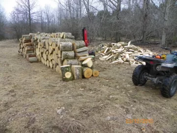

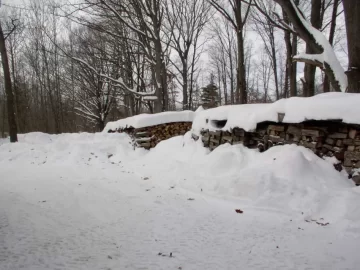

Here are a couple pictures showing how we do it:

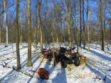

Cut wood during winter months.

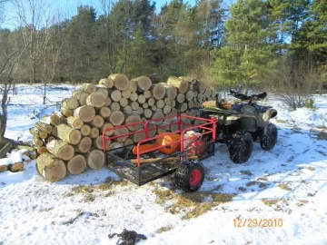

Stockpile the winter's cutting and wait until Spring.

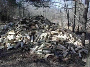

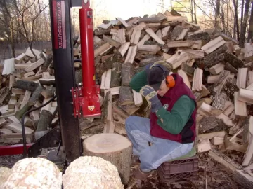

Spring! Time to split.

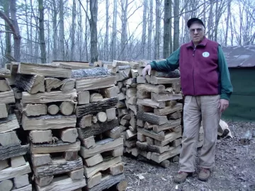

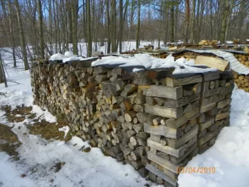

Now it is time to stack the wood. Notice the poles under the wood to keep the wood off the ground.
All stacked and then wait until snow flies to top cover. The closest stack in the second picture is covered with rubber roofing. We still prefer old galvanized roofing for the top covering though.
Ah winter! Now the wood is covered and it will just sit in the stack a few years before being burned.
