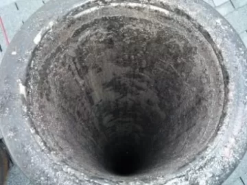

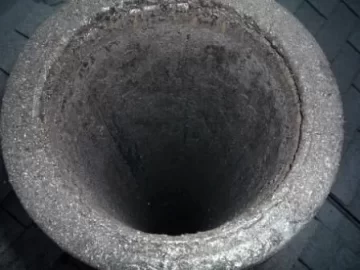

Well test results are in and my opinion is they aren't worth anything but the heat they put out.
Before...
  • [Hearth.com] Creosote logs...Do they work?
Before...
This chimney doesn't look like a good test candidate, it looks like it has not been used in a long time.( You must be doing it right) The top is were you should the most build up of creosote. But I completely agree, a waste of money. I think it just makes people feel better in between visits by the chimney sweep.
