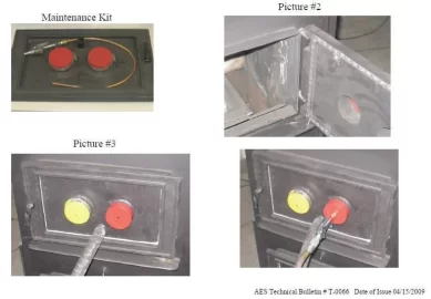

AES Technical Bulletin
MF3645 Maintenance Kit
Product models covered: Countryside 3500 Series, MagnuM 6500/7500 Furnaces
Topic: This technical bulletin will be addressing the MF3645 Maintenance Kit, cleanout door, how
to install the door and how to clean the appliance with the door.
Tools needed: Rubber mallet.
Procedure:
♦ Take the door off the appliance. Sometimes a rubber mallet is needed to tap on the bottom of
the door to lift it up.
♦ Install the cleanout door on the appliance. Line the cleanout door up to the hinge pins and
press down on the door to install it on the appliance (see picture #2).
♦ Close door and attach ash vac to tube as shown in picture #3.
♦ The first time you use the kit, drill ¼†hole in pipe caps.
♦ Insert air nozzle tube into appliance bending tube as needed.
♦ Turn ash vac on and blow air through the nozzle bending tube as needed to insure tubes have
been cleaned.
♦ Move tube to other pipe cap and repeat process.
