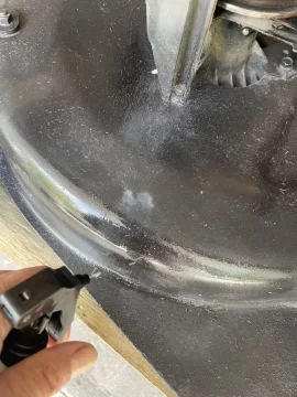

First of all there were no layers of matted caked on grass! That is due to the dry moly application last year that creates a nice non stick surface around the blades!
This year, I just wire wheeled, blew out with the compressor and cleaned with acetone, then sprayed on the moly.

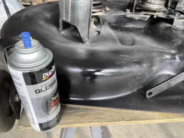

Again last year the top was primed with flat black and then the Satin Black for the top coat.
This year after the wire wheeling blowing off with the compressor and only one spray of Satin Black for the top coat it is back to new looking condition!

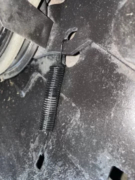

I did have one slight problem. The spring return idler part # 169022 which is just a small spring was damaged and hanging on by a thread! So to avoid a mid summer disaster, I ordered up a new one from SearsDirect that will be here in a couple days and makes it so much easier to slip on now before installing the deck!
