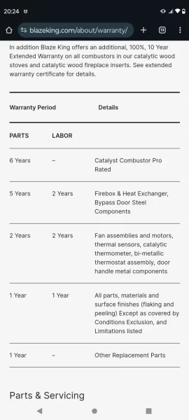

That’s a tough spot. I don’t see how one could do it well with the pin still there. What is the warranty on it?
I think it's a 5 or 6 year warranty.
5 years.
