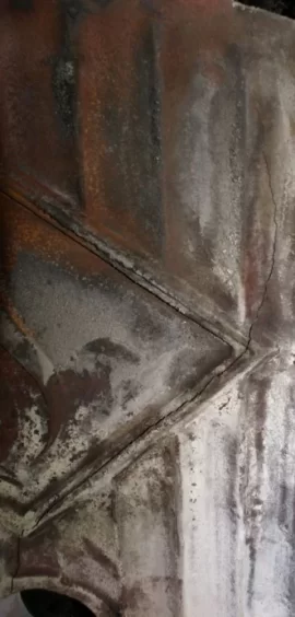

I have just found the famous Mt Vernon AE crack, mine snakes up around the right side of the diamond. I have emailed a question on quadrafire.com asking if they are re-designing this baffle or what, and I am about to call the dealer here about replacement.
My questions to the forum in the mean time, are:
1) can I remove the baffle for cleaning without risking it falling apart?
2) does the crack have effect on gasses that make it into living area, or does the crack effect the burn?
Any advice is appreciated.

here is a pic of the crack, it rises from the top edge of the bottom opening, up along the sculpted ridge on the right side of diamond, and nearly up to the vent at the top of the baffle.
Would you chance lifting this baffle out to clean before the replacement arrives?

That is one of the worst I have seen. If you need to keep using the stove I would drill a very small hole at the end of the crack to keep it from spreading to the top. If the baffle splits in two pieces and falls into your glass you could have a major problem. When can you get a replacement from your dealer?
