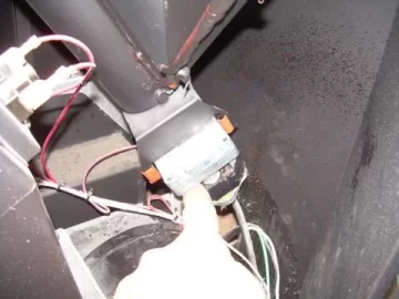

I tried lightly spraying a coat of WD-40 at the base of the auger, where the auger motor attaches, but it's not making any difference. I can adjust/alter the sound if I move the auger motor back and forth here:
http://i512.photobucket.com/albums/t326/cptmoney/Country Stoves - Winslow PS40/DSCN1853.jpg
That's my finger in the middle of the pic, pointing to the auger motor - flash sorta white-washed everything.
If I wiggle that auger motor back and forth, I can alter the sound, but not make it go away. I tried shimming the motor into one position, as it has about 3/16" of play. That made no difference.
Can I empty the hopper and lubricate the auger sleeve/tube/screw? I figured that this might be a bad move, so I've left it alone. The sound is directly related to the auger/auger tube/auger motor, however - so I know I'm close.

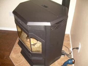

Here's the stove -

And here's the motor that I'm referring to -
I can alter the sound by moving it around. Can't make it go away, per se, but can change it. It has something to do with the friction of the auger and auger motor. Not sure where to go from here.

you may have something jammed up in the tube. that auger bolts in there on the top and bottom so thats in there pretty good. its no fun to take that thing out, I tell you.
That was my first thought as well - but the auger is working fine. Been running all morning, but making noise the whole time.
It's burning right on schedule, so whatever it is, it's not impeding the auger.
I believe you already diagnosed it correctly. Get an Exorcist in there to scare BlackBeard off.
with all the reduction gears in the gearbox those auger have fantastic torque. Even if something is jammed in there it may not impede the flow of pellets or the movement of the auger. Maybe if you take the motor off and put power to it you can eliminate the groaning coming from the motor itself. Then at least you know you'll have to pop that auger out. Theres not really much else to it. I'll cross my fingers and pray to my gods that it passes (like a kidney stone).
