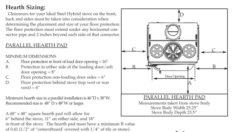

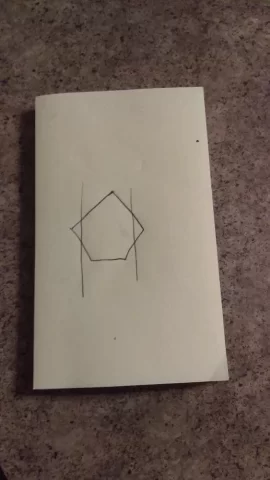

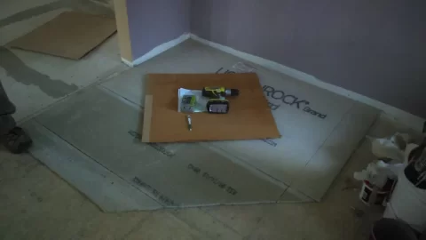

I'm trying to build a hearth and due to the dimensions, it is huge and taking up almost 1/4 only living room. is there a reason why the side corners of the hearth has to stick way out, or can the side corners be chopped off at all? picture of what it now currently looking like and a picture of what I'm referring to when I mean by
chopping off the side corners.
