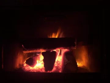

Corie came out this afternoon and he checked everything out, all is safe, and I learned a lot. I am using my thermometer and right now adjusting to get it a little cooler, down to 350 so doesn't get so hot in here. But I learned how he starts fires and for the best burn in my type of stove, and showed him I understood as he made me lay pieces of wood on the fire. He taught me how my wood stove burns (front to back) as is deep. I know how the wood should look burning, what sounds I may hear mean. I even can split my own kindling with a hatchet out of big pieces though I must say that is going to take some practice.

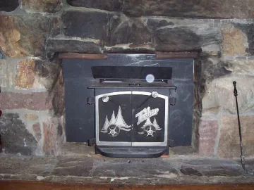

All the stone around my old fireplace is good protection and when heated up will be good radiant heat for me. I learned the mistakes I was making and a lot about how wood burns, the whole process and feel more confident now. The gasket is fine as is, so Corie did not have to replace it.

So I will keep reading and learning here. Right now am burning at 350 degrees consistently (just checked) so as not to get too hot. I love the thermometer.

I'm just glad I could help!! Here are the photos of the install, so you all know Karen and I aren't making this story up!!

What was the pipe they put up that chimney Corie?
It was an 8 inch flex liner. Chimney is fully lined to the top and has the proper cap installed. Liner to stove connection is sealed with furnace cement. The temperature outside was around 55-60 degrees (we didn't check), but the stove still had pretty strong draft. I imagine when the temperature drops she'll have a pretty strong drafting setup.
It looks very good to me. And the large thermal masss of the fireplace (its huge) is a real asset to the setup imo. Once she gets the stone to temperature, it'll radiate warmth for hours after the fire has died.

Sounds like those guys did a lot better installation than it sounded like it might have been. Good on them!
Yeah, I was eyeing that stone fireplace longingly. Lotta mass. Those are some big rocks in that thing. That Fisher is gonna heat'em up real good.
