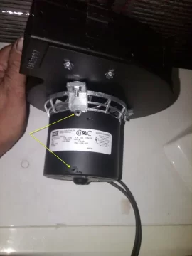

Last Friday I had the Company I purchased my Enviro EF2I Insert (Mfgdt. 2008) from last year do a yearly cleaning. ( I should have listened to members here and did it myself.)
Before the tech was finished I had asked him about putting a couple of drops of oil in the convection motor and he told me that was incorrect because Enviro changed the bushings to be oiless. Is he correct?
I pulled out the manual (dated 2005) that came with the stove and showed him where it stated as part of bi-annual mainetenance to put 2 drops of sae20 oil in the "oil" ports on the convection motor.
He told me he would find the proper answer but its been a few days and I figured I would probably get a quicker and more accurate answer from Hearth.com.
