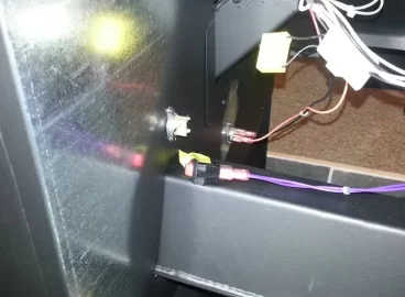

I started looking through the manual for info. There was nothing about the convection blower always being on in the troubleshooting section but I did see in the reference section in the back that snap disk #1 controls the blower (and is connected with two purple wires). So I open the side panel to look for the snap disk and see 2 purple wires connected to a toggle switch and nothing connected to the snap disk (see picture attached).
I just want to see that you all agree the toggle switch should not be there and that it's safe to hook up those purple wire to the snap disk.
