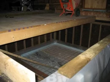

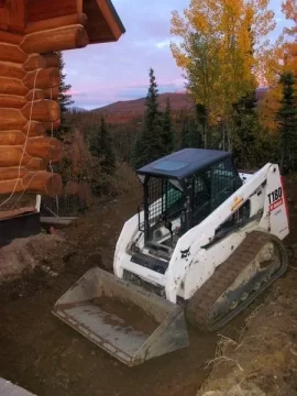

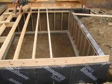

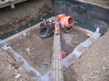

I decided on a 10' x 14' arctic entry that will house the Tarm, 1/4 cord of wood and all the hats, gloves, coats and boots in the universe. The Tarm will sit in a small boiler room (4.5' x 8') but one of the 8' walls will be removable for maintenance and repair of the boiler. I excavated deeper than I originally planned and decided that the two tanks horizontal in the AE crawlspace would be a better choice than setting the tanks on end and losing ~24 sq ft of floorspace in the entry (LOTS of gloves and boots).
