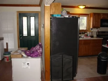

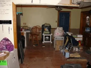

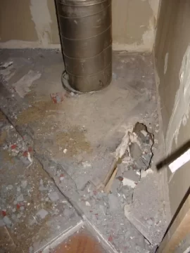

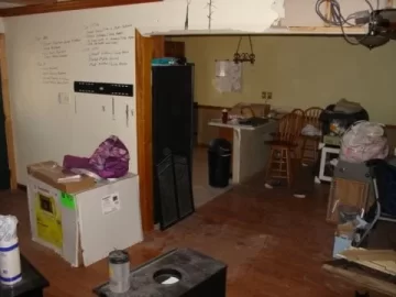

The top two on the left are where the old zero-clearance unit was, the tube us just resting on the floor and will be removed and hole in cieling boarded up today (it got cold last night!), Top right picture is from the hallway looking at the front door and kitchen area. Bottom two are from the living room looking at the kitchen.
I would like to install my free-standing stove on the end of the wall dividing the kitchen and living room. I want to build the non-combustable enclosure around the unit on the end of the wall and have the face of the stove about 3-5" into the living room and the hearth the proper amount past that, I will install the bulk of the enclosure or the plain but of the stove if I decide not to enclose it in the kitchen side. It would be great to make an enclosure up to the cieling as that would not only hide the chimney pipe but would also make a nice slot for the fridge to fit into. Then I would install the blower assembly facing the hall to blow heat down the hallway.
Thanks again, hope this helps with any ideas! Need any additional info just let me know.
