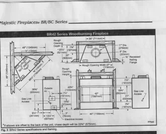

I have identified the Regency CL1200 as the only choice for an insert due to the fact that it fits in the majestic factory fireplace and matches the contemporary style of the home. Also, we are on wooded acreage so access to fuel is not an issue. I estimate that we use approximately 1,100 Gallons of propane/season for heat.

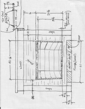

2) I have an irregular surface surrounding the fireplace opening (cultured stone). Is there some reasonably aethitically pleasing way to finish off the seam between the stone and the sheet metal backer face plate. I will need a backer face plate as the fireplace opening is wider than the insert.
