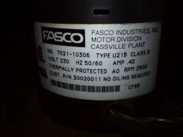

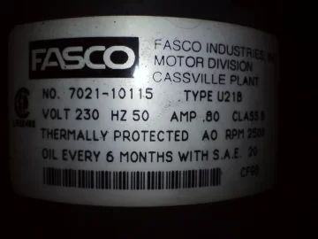

My Whitfield Quest Plus is from 1998 like your Advantage Plus. It still has the original blowers running perfectly well.
My convection blower needs oiling twice a year with non detergent SAE 20 oil. "3-in-one" oil in the blue can should be fine for this.
My combustion motor requires no oiling. See pics of my motor labels:

To the left of where the wires enter the motor and just left of the black clip on the fan end are oil ports. A couple of drops of electric motor oil will extend the life of the bearings.
A good cleaning with a blast of air to clean the windings will get some air thru the motor to help keep it cool.
I use a syringe with a long needle to service these ported motors and use a synthetic oil.
Good shot of air to clean out the dust bunnies is usually in order and the simple service can extend the service life of the motors to several decades.
