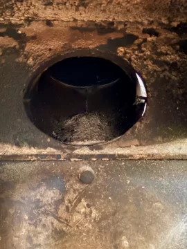

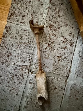

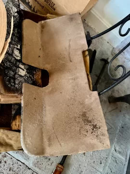

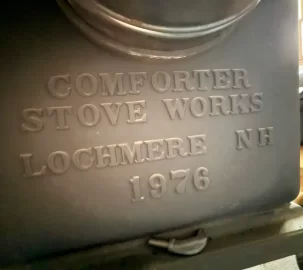

Hey I am new here and new to wood stoves. My uncle gifted me a Comforter Stove Works Wood Stove along with the triple walled stainless steel chimney pipe. I am looking to install this stove in my living room to heat my house. Just this past weekend I sistered up the 2x8 floor joists in my living room to make sure it was able to withstand the weight of the stove and hearth.
Being new to wood stoves I have a lot of questions to make sure I’m doing this right. I just ordered a copy of the NFPA 211 to reference. I am wondering if there is anything more I need to do in order to get this stove operable. I just got it sandblasted and I am going to take off the old gaskets and install new ones, then was planning on putting a light in thru the cooktop hole and sealing up anywhere lights could be seen shining out with the proper caulking, then painting it.
Also, the stove is rear-vented with an oval shaped hole. I was figuring on putting a double-walled oval to round adapter onto that outlet, then putting a double walled clean out tee to the double walled pipe going up, then to the fire protection box going thru the ceiling and changing over to the triple walled stainless steel pipe thru the roof, flashing that and adding a chimney cap.
My question is, if my hearth is built with the 1” airgap - created using 1” metal studs to my sheet rock, then durock on the face of that with brick veneer, as well as using the double walled pipe, how close can I get the double walled pipe venting out of the back of the stove to the brick veneer wall of the hearth safely? Also is there anything I can add as far as protection to get this stove as close as possible safely?
Thanks to anyone reading this, I will post pictures of the stove before and after sandblasting.
