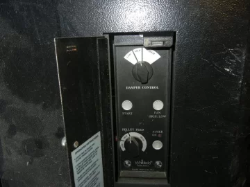

I have a Whitfield (Advantage II I believe) that just started burning way too fast.The combustion adjustment is now as low as it can go and the auger speed has been increased. The flame fluctuates every few minutes, from barely lit to 'normal' and back again, and looks like the combustion blower is on full blast. (very active flame, a lot of embers lifting out of the grate.) It cannot stay lit on the lowest setting; the pellets burn up too fast and the flame goes out. I have not changed pellet brands.
Two weeks ago, I found the vacuum switch was broken, keeping the auger from working. Until the new part arrives, I just bypassed the switch and the stove ran normally.
Just last week, I had the opposite problem: burning too slowly (right side only) and ash/unburned pellets clogging the grate. I cleaned the stove out well, vacuumed, brushed, etc and then this started.
Looking around, I see a lot of issues with the blower not running fast enough due to the limit switch(es) but nothing about the blower running too fast all the time.
