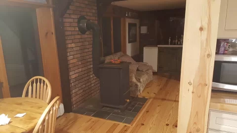

I will be replacing this stove (not sure with what yet) and I'm trying to determine what my clearances will need to be. The wall behind the stove is actual brick, not brick facing or veneer. Behind that is a layer of sheetrock, which presumably has the studs of the outside wall of the house behind it. If there is a gap between the brick and the sheetrock its a small one. From what I've read, this does not count as a non-combustible wall because there is no air gap between the brick and the sheetrock. If that's correct, what about doing another layer of brick (or stone) with a 1" air gap between that layer and the brick? Disregard the couch-the current stove is not used and once we install a new stove the couch will be gone.
