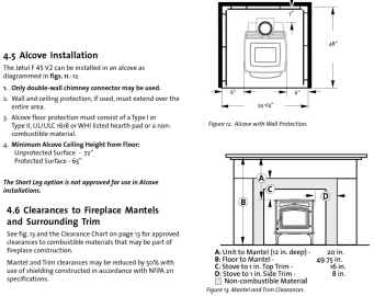

So I plan to make the alcove just shy of 48 inches deep since that is the max alcove depth listed for several stoves I have looked at. Now the house is a timber frame so there are 8x8 posts on each side of the alcove. The posts stick out 8 inches into the house( posts are inside the house /SIP panels are anchored to the outside of the frame). The rock or tile on the inside of the alcove will terminate into the posts and then the posts will deepen the alcove by 8 inches. But the ceiling of the alcove will be flush with the interior wall of the house and will therefore be 8 inches shallower than the sides of the alcove. So which can’t be over 48 inches the top or the sides?
put more simply the sides of the alcove will be 8 inches deeper than the ceiling. Can I use the ceiling as my max depth since that is where the heat will be escaping? Or do I need to make the walls 48 deep and then the ceiling will be only 40 inches deep?
Thanks
As the manual's Fig. 12 diagram shows, the wall's maximum allowed depth is 48".
