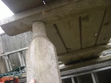

Only if it comes out nice.Zap...dont forget pics....upon completion....View attachment 65014
Do you think the legs are attached with screws or by a tenon? What size tenon package would be the best?Great. Those tenon cutters are a small investment. With a large supply of wood, you could build chairs and benches for other uses. They will pay themselves off in not time.
If you are using two planks side by side for the top, you would probably need a piece of 2" x 3" pine under the planks to keep them together. One at each end of the table. You could use wood screws up from underneath the 2x3 to secure the planks. That 2x3 then could get two holes for the legs. I would use gorilla glue to secure and a small square-drive finish screw to hold the tenons into the hole drilled in at a slight angle. I'll grab a few pieces of scrap wood and put up a pic or two of what I am describing.Do you think the legs are attached with screws or by a tenon? What size tenon package would be the best?

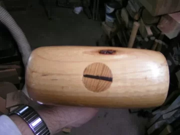

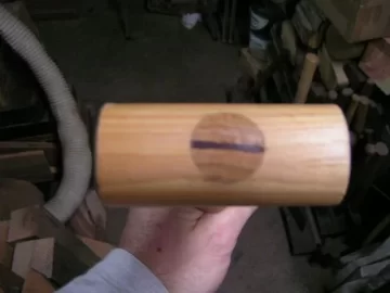

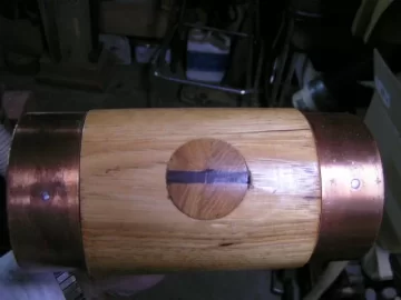

Looks great Thistle, don't take this wrong but is that some type of a sledge hammer?
zap
The picture is just pieces of fencing. It was pre-cut on the ends of the rails about 1 1/2" in diameter.Thistle, thanks. Guess I better find some material for the legs this month.
fishingpol, what size Tenon Cutter did you use on that leg?
