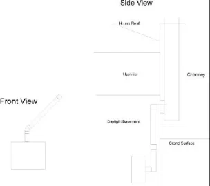

Yes, I am a little confused. I'm not great with building terminology, Sorry. Below is a description of my install I will try to put some actual pictures in when I get a chance.
My stove is vented directly to my chimney with approximately 2 feet of the pellet stove 4" vent pipe sticking into the 8" Chimney. The vent pipe is at approximately 45-degree angle to get to the Chimney inlet. The chimney is lined but I am not sure of the specs. As I said before the bottom of the chimney is open. I have attached a rough drawing of the install that is not to scale by any means.
I have a fresh air vent directly behind my stove, and it pulls air from the same side the chimney is on and is approximately 4-6 feet away from the chimney.
I have never smelt smoke in the house and the vent pipe does not seem to leak. I clean the vent pipe every ton of pellets due to the 45-degree angle.
That is everything I know as of now but will send more details if need when I get home tonight if needed.

So the chimney outside is bottomless
the Outside air is 4-6 feet from the chimney

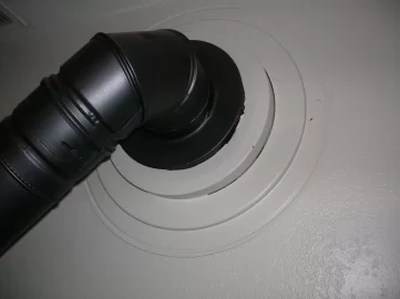

Okay now I have some pics. But first a few questions to answer. Live in Montana, weather was cold (high of -5 F) the first time CO detector alarm went off not as cold second time but probably in the teens. There are other gas appliances and dryer in the basement but the dryer was not on either day, and the gas hot water heater is in a seperate room that is attached to the garage with good cold air available. The chimney is steel and yes the plug at the bottom is missing (is that a problem?). Professional install.
Now the pics. First just a pic of the unit itself and the vent pipe inside.
Second close up of wall thimble

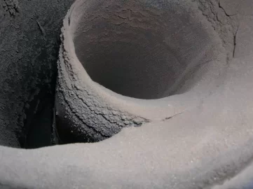

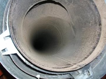

More Pics
Chimney outside can see the Tee out let on top of pic
Pic inside chimney Tee with view of stove vent

  • [Hearth.com] CO detector has gone off twice!
i'm not completely sure what i'm looking at in the right-hand picture, however if you have a cap missing from the clean-out T, i would say that yeah, that's where you need to start; PLUG IT NOW.
Good info Fish. You're doing great. Get a proper endcap installed on the bottom of the 8" stack. That's step one.

Herein lies the problem:
First clean that pipe...... then put the cleanout cover on it.
Second you have a pressure vented stove which means that most likely the exhaust is blowing out that cleanout and not going up the pipe.
Third the fresh air intake setup that is there is allowing that exhaust right back into the basement. (how close is this to the pipe outside?)
fourth it doesn't look like the joints on the pipe inside the house are sealed. Seal them up.
and last Good luck and keep us informed.

So I sealed the thimble with high temperature silicon. I went to the dealerto get a plug and they said all I need is a 12" slip cap and screw it into the 11" outer pipe. The T is a 8x11" insulated T. This seemed a little weird to me I asked a couple of times to see if I wanted one to seal better. Do you think the 12" slip cap will work or should I get the actual plug that goes with the T? What is the best way to clean out the vent, vaccumn? Thanks again
Was that chimney CLEANED before you had the pellet stove put in? It looks pretty cruddy, definitely needs a sweeping.
I agree on the need for a cap, it would look to me like the smoke from the stove is probably going out the bottom instead of up the chimney like it should.
The other thing I'd consider is trying to get that 4" pipe from the stove extended just a little so that it's end is about even with the inside end of the "T" and if possible fill the rest of that void around the 4" pipe with something to keep the smoke from trying to travel back down the outside of the 4" pipe and into the house. Figure out where you want the smoke to go, and block all the other alternatives is the basic idea.

The pipe inside the house.......... the pics showed no sign of sealant at each joint....... not just the thimble those elbows for example can leak, and every joint before and after should have the hi-temp silicone applied probably clear in your case....... If you need to have a disconnect, a portion of the pipe can be taped with a high temp foil tape for ease of disassembly just make sure you use the right tape....
