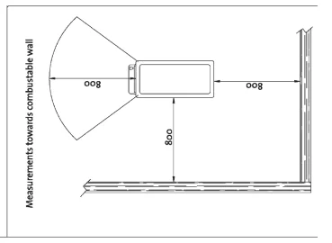

The international manual for this stove lists the distance side and rear at 800mm or 32". This can be reduced to as low as 12" with the proper wall shielding. The US manual (with UL spec) shows clearances depending on how the stove is connected. This is to include the clearances for the connector pipe.
[Hearth.com] Clearances for older UL Listed Jotul F118[Hearth.com] Clearances for older UL Listed Jotul F118
Here is a primer on the topic.
