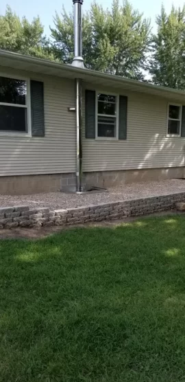

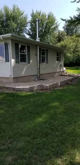

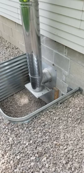

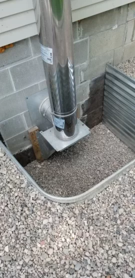

Food for thought. The block, well, fill and rock cost a few nickels. Not a huge amount. Really cleaned up the look in the end.
