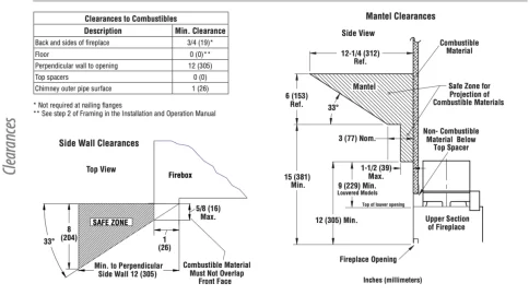

That looks ok. This is what popped up online.

Thank you for answering the query. Mantel is 6 inches wide an 8 or 10 inches deep floating shelf instead of angular one as shown in the diagram. Do we need to move it up in that case? In the picture, mantle clearance with 33 deg is my concern. Our mantel starts at 18 inches but then extend 8-10 inches. Also which part of the diagram indicates the side clearance.
