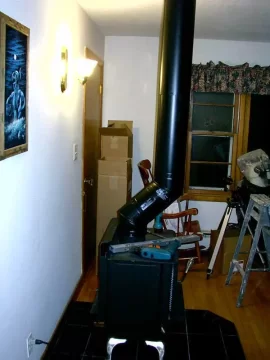

I not sure exactly what your setup looks like, but I can run a brush all the way from the top down through the jog into the stove.
You do need to give the rod a firm push, but it's not too hard. BTW the rods I have I think I got them form Lowes.
