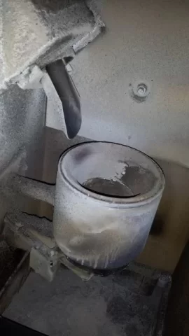

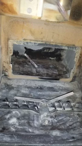

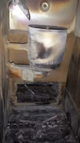

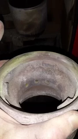

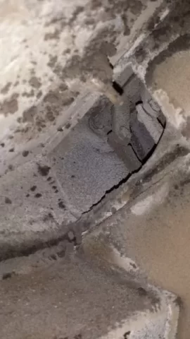

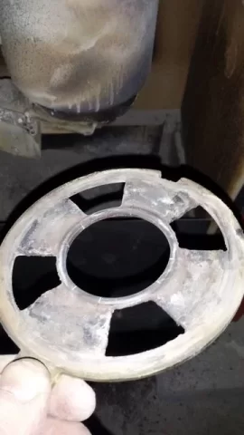

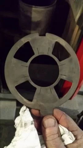

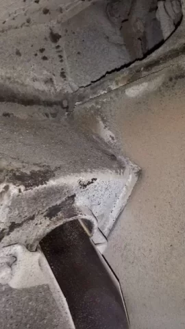

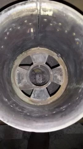

Cleaning went pretty easy, though I went slowly for this first time. There wasn't that much crustiness to clean. The tip in the manual about soaking the grate plate in water before scraping with the putty knife really helped. I didn't soak anything else. The holes weren't clogged, but I did run a 3/16" dowel through the air pin's holes anyway. Note: The cone's holes are 1/4".
Something I could see forgetting is the hidden ash auger (for the flyash?), which is behind an access panel.
I didn't clean the ID fan-the manual calls for doing that once a year.
Here are some pictures, in no particular order:
