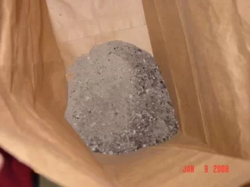

Here is a pic of the results from my mid season cleaning last year- my first year burning with less than perfect wood.
It is in the bottom of a plain paper bag- less than a cup of dry gray stuff.

Wow, I wish i took a pic. It wasn't sticky but it wasn't ashy either, bigger pieces sort of the consistency of rice. This is my first year with the corrugated liner when i used to sweep my chimney i would get fine black powder.........is this a liner thing?
