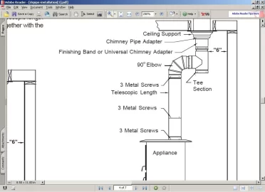

This year I installed a “T” for easy cleaning and inspection. Last year the stove pipe just went straight up from my stove, and I had to disassemble the black stove pipe or go on the roof for inspection of the chimney, which in the winter with snow on the roof is no fun. Now with the “T” installed its just a matter of taking the end cap off the “T” for a quick view and/or cleaning of the chimney.

That's the kind of thing I was thinking about. At least you could pull the cap, plug the pipe going into the stove with a rag, go up and brush the chimney and vac the mess out of the pipe. It seems a bit better than the trash bag approach. Have you found any way to clean without going onto the roof? I wasn't sure if the transition to the T, even though it's capped, would cause any degradation of the draft.
Here is a picture of what my setup looks like

Thats different than what I envisioned, I thought you put a tee in your straight pipe, with the center leg of the T coming out. Your setup is interesting, you really can clean the class A from the inside that way, and see right to the spark arrestor. My creosote buildup has always been in the last foot or so of pipe right by the arrseror, where things cool off.

That was my primary reason for installing it this way, so that I would not have to go on the roof in the middle of the winter, and cleaning the class A chimney would be easy and could be done frequently without much hassle, Everything is done from inside the house.
If you have room behind the stove and it is rear exiting that Tee would replace the need for a 90 elbow and also serve the same purpose for inspection and cleaning
Does anyone get any dripping from the tee on very rainy days? Seems like it would accumulate water in the right circumstances.

I have only had mine installed for 2 weeks, we had a good rain storm a few nights ago, and I did not get any dripping from my Tee.

No problems in ours after a year. Not surprising because the design of the tee cap is such that you would have to have > 1/4" of water accumulate before it would overflow and drip out - there is a rim around the cap.
