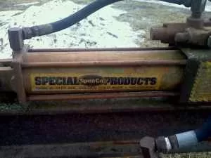

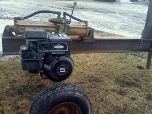

what do you think? should I look into it?
(broken link removed to http://quincy.craigslist.org/grd/2225849827.html)
For sale I have a nice gas powered wood splitter it has a 2 speed hydraulic pump and Briggs and Strattion engine on it. It has a 2 inch ball hitch and does a good job. I am asking $675 for it and for more information call 1-660-341-1762

Seems like allot of money for the type. only horizontal. looks like maybe home made.
$900 to $1,000 buys a new one (20+ ton & some nice features) that works horiz/vert at TS.
working height looks to be at the "back breaking" level. Lots of bending over.
Just IMO
run like a scalded dog. You can find one year old Husky 22 ton models on Craigslist for 800.
Yeah dont bother. I have been checking CL for a good splitter for over 1 year. I have come to the conclusion it just is not worth it. The good news is when you buy a new one (I am going for the Huskee 22) and ever want to sell it, it will go quickly and you wont lose much.
Sorry to disagree with everyone, but I would check it out before I ignored it. Does it run? Check the cylinder rod and the valve spool for rust. Any hydraulic leaks? Does the enging smoke?
Check the frame for cracks or poor weld repairs.
If all that stuff is good, offer $500. The quality of the components of this splitter is much higher than that of a huskee. Chances are this splitter will outlast a new chinese one by far.
