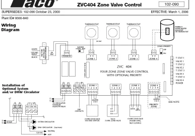

I have an eko 40 I am setting up to heat a 500 gal tank (primary loop). I have a two loops off the tank each with separate. 007 taco circ. pump supplying an air exchanger on one and a flate plate water heat exchanger on the other. I am using a zone valve control relay (taco zvc 404) for the thermostat input and zone valve control output.
My question is this: what type of switch would i need to control the 115v pumps with 24v input???

I believe that Taco zone control box has a relay or two offering dry contacts. Listed as end switch and dry contact. These can be used to switch a 120V load, pump, boiler, what have you.
Wire the control thermostat to the 404, and switch the zone valves as well as the pump loads.

RCA: For whats its worth I think I went through the same problem where I had planned to use zone valves(24v) on part of my system and circ pumps(120v) on the other. I originally bought (or was sold) a 406 Zone Control (24v output) but ended up getting a 506 Zone Control (120v output) and using only circ pumps. You may want to look into doing the same, forget about any zone valves and just use your pumps for the same purpose
I see the utility of the zvc 404 now......the secondary pumps will need a 24v relay coil just because I want them to run when needed. I will set up the storage tank as a zone (along with the other zones on the 404) then use the switch end and dry contact to run the boiler and primary circ. pump,,,all off the zvc 404 control......
Where I was getting hung up is trying to rig the secondary pumps with the zones of the 404 but there are no 120v out (with the 24v out) to run secondary pumps and valve.....then i thought there must be a 24v to 120v relay.........now i see how they all work together....
