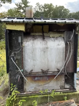

PS I bought the house five years ago and this is the first year I’ve run it due to high oil heating costs. I had to remove sides, strip out all old and mouse chewed insulation, Cleaned whole thing, re-insulated, and put into service.
[Hearth.com] Circuit breaker won’t reset on Heatmor CSS200 [Hearth.com] Circuit breaker won’t reset on Heatmor CSS200 [Hearth.com] Circuit breaker won’t reset on Heatmor CSS200 [Hearth.com] Circuit breaker won’t reset on Heatmor CSS200

View attachment 318584 View attachment 318589 View attachment 318590 View attachment 318592
Wow! Great pics. I have a Heatmor 200 and I think I'll put this task on the todo list for next summer. Did you fill that top cavity with all insulation?
Yes. Completely filled with rock wool. Easy to work with it and can cut shapes for good contour when needed. Good luck with your project.
