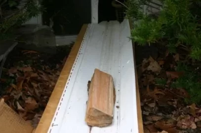

I got real tired real fast lugging firewood down the basement steps in a roomy Home Depot shopping tote. I always put more splits in it than I should have. So they'd bang against my shins going down the stairs. We're just talking shoulder fires here, not 24-7. This just wasn't gonna work. I took a look around...

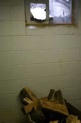

There's a basement window near the stove with one pane glass, one pane OSB. Aha. I cut a hole 12" square in the OSB. I fashioned a chute from an 8' piece of vinyl soffit left over from a summer project, and some scrap 2-by-3s.
I still had the large box my liner came in, so I positioned it in the drop zone under the window and tried three test firings. Bingo.
In no time, I wheeled two wheelbarrowsful of firewood over to my chute and chuted (chot?) it into the box. Now I'm bored. There's nothing to do...
Okay, I hear you asking, "What about the hole?" I just happened to have a vinyl doggie door cover that I wasn't using. It goes over the opening, held in place with a bungee cord and two screw eyes.
The best part is that I've decided the location of my next firewood acquisitions will be right next to this basement window. I won't even need the wheelbarrow. I can plant petunias in it.

I would put sides on the chute or put some protection on the other window in case a split goes off course.
Good eye! That actually happened until I lowered my end of the chute to slow down the rate of descent. Now sometimes I hafta give 'em a poke with a pole...

Thanks! You do this for a while and you notice these things. That's why a lot of wood scroungers will put a metal grate across the back window of their truck.
