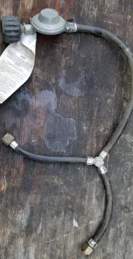

I did not find anything useful at team blue homestore today. At team orange I found a fixed output regulator ( 11 inches water column) with a 2-3 foot hose on it for $25. I looked at a bunch of gas BBQ grills at WalMart. The fixed output 11"WC regulator is ubiquitous on gas BBQ grills, even my 11 year old one at home, and the side burners on these are often rated at 10-12 k BTU/ hour.
Gas grills are not typically well enough built to support a full canner on the sideburner, but if you find a gas grill with a side burner on a curb somewhere, there is hope. You need all the hardware from the male threaded fitting that accepts the gas line to the burner. The fuel orifice or jet is going to be in that assembly, you need the flame adjust knob to work, and the air shutter. If it has a fuel line and regulator on it, try them. The single stage regulators are clearly throw away diaphragm types, they either work or not. Hook it up, open the tank valve, check for leaks. If it is leaking, $25 at a hardware store, I am sure those are on Amazon too. Now all you need is to build a fireproof support that can support the canner and you can bolt your burner to. You might could take out the burners in the grill area and move the sideburner into that central area.
11 inches of water column pressure works out to 0.4psi. You can get a LOT of BTUs out of that. With ten feet of 1/4 " ID pipe and no fittings to add resistance to flow, it can support 35,000 BTU/ hour. With wider lines and shorter lengths 11"WC can support a LOT more BTU/hour.

Gas hose with fixed output regulator at 11 inches water column was found to have a wye on the output hose, a common finding among gas bbq grills with sideburners, and crimped fittings. One output leg of the wye feeds the side burner, the other the main cooking burners within the grilling area. Crimped fittings cannot be adjusted without significant investment in floor standing hydraulic equipment, thus the hose was returned to the transfer station with the rest of the remains of the dearly departed, as this side project is already janky enough.
