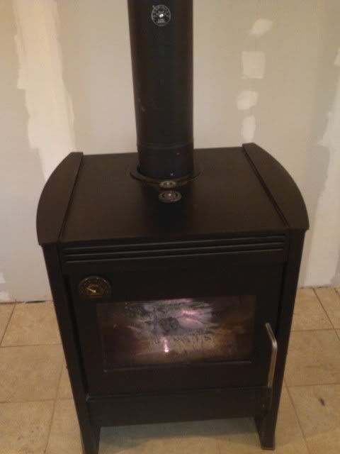

I'm am somewhat picky about quality as it's actually my job to look for defects. Obviously the stove isn't perfect, you can tell some things are slightly higher than others, a little crooked... I don't know if things are supposed to be like that or not but it does stick out to me at times. I doubt most people would even notice really. The welds are pretty sub par, but will no doubt do the intended job. There is spatter left on the stove, a few boogers are down near the loading door that I scrapped off. There's quite a bit inside the stove near the bypass. I don't know if they welded that part after it was assembled or not, but that would be a good reason for the spatter and lack of fusion on the welds. The only thing that really did bother me and cause a little bit of trouble I included in pictures. Right on the stove collar, there's a sloppy mig weld that has a start/stop with a lazy fix. It would've taken no more than 30 seconds to put a grinder/dynafile to it and smooth out the start/stop and make sure it doesn't leak. On the other side of the stove (the back side of the stove) it's very lumpy and my DVL connector pipe actually was rubbing and was being help up on it because of how high the weld was. I was tempted to just take a grinder to it myself, but I didn't want to in case I had to warranty the stove or anything. I didn't want to do something that would nullify it. So I just shoved the DVL connector on there and made it fit... It took ended up pushing the inside of the DVL pipe away from the stove collar so it's not as tight of a fit as it probably should be, but I used up a bunch of rutlands to make sure it seals. Could have also taken a little wire wheel or brush to the welds to clean them up... but now I'm just being picky.

Here's the lumpy weld that held up my DVL pipe. Notice that the vertical seam isn't welded on the inside. They must be fairly confident that outside weld sealed it up. I'm not so confident about it, but I'm not the QC on the project here
Start/stop
