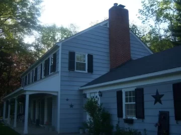

chimney pics before flex install...??
RAY_PA
May 13, 2008
319
Northeastern PA
Here are a few shots of the chimney that I will put the flex liner in, for the PE Summit. Any thoughts or ideas to aid the install or preformance? (The lower part of the house, with the black star on it is an attached, uninsulated 2 car garage, no heat in it)
Should I clean the liner before I install the flex?

pic was taken from the top. It is black and has some scaley build up on it, not alot, tho. When it rains now, we do have that sooty aroma for a little while.

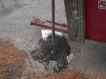

Roll yourself a big blob of chicken wire tie it in the middle of a good rope drop rope end down to opening in home, have one person up top, another at the bottom, pull said rope back & forth.
Ala Elk:
  • chimney pics before flex install...??
