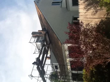

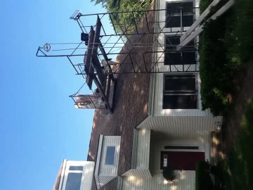

Here's an ouch...$4400...but well worth it. listen to BHOLLER, professionally installed after years of duct tape and putty.
[Hearth.com] Chimney needs repaired...ouch
Yeah when you need allot of setup like that it can get expensive in a hurry. In our area $4400 would be high for that but not that high unless that included a liner as well
No liner except for 1 section I knocked over because I was Curious George... the chimney was 3 flues, about 7' high and 6+ wide.the chimney was also filled with about 90 mud buckets of sand and rock insulating the liner to the brick. It's the weekend Bholler, just tell me it was a $10k job and I made out like a bandit. also included new cap and sealant (which I requested).
I dint realize it was that big. In that case you made out great lol. Seriously at that size it doesn't sound to out of line. especially with the added hassle of removing all that sand. We have run into a few like that. One was filled with shale that was a real pain in the ass
