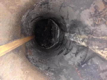

Hi I'm needing to install a chimney liner into my existing clay tile chimney. The issue is my chimney goes downward and then into a 90 degree into the house. The vertical doesn't run past the horizontal run into the house so I don't think the t snout piece will work. Is there any other options anyone knows of for this issue? There's not a clean out on the existing chimney, a wood stove was hooked up to it before. I appreciate any suggestions or help!
cut the bottom of the tee down so it fits if you cant get in there to clear the area to get more drop
I attached a picture of what I have, in your opinoin, does it look like it'd fit if i cut it down to near flush of the horizontal on the t snout piece. It posted the pictured wrong, if you rotate it Clockwise 90 degrees, you can see the white stuff on the bottom of the chimney

it would be much better if you could clear some of that mortar from the bottom to get some drop but if you cant cut the bottom of the tee down to fit
What do you mean? You should always use a tee at the bottom of the liner in a situation like this then you come out of the wall with rigid stainless and connect that to your pellet vent.

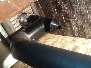

Not sure I fully get the setup, but I had a T put in a straight drop down - see attached...Chimney Liner install question
Yeah that is a totally different setup nhcpa the op has an chimney that comes down then a crock through the wall the tee will be inside the chimney.
