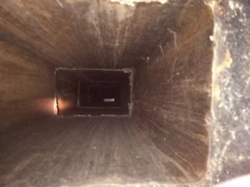

Chimney is in excellent condition. In the picture taken from the firebox up the chimney, you can see the condition and cleanliness, aside from a few cobwebs and mortar sticking out. Notice the strip of light at the top..... That is due to the slight offset near the top so that the 'view' of the sky is only partial. ID is 7" x 11". Insert says it wants 6". I talked to the company and they said 5.5" is ok if I need it for the flue size. I really wanted insulated for efficiency purposes. Haven't been up in the attic to see if the combustible clearance is up to code. Figured I would be doing insulated and didn't need to check. 25' chimney, interior build.

Is the offset on the 7" dimension or the 11" dimension? Or both? If only on the 11" dimension there will be some wiggle room.
