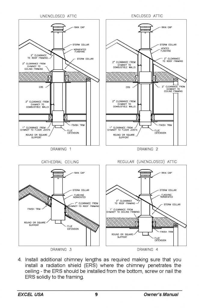

I've seen the selection at lowes and it sucks. After using Excel products i won't use anything else.

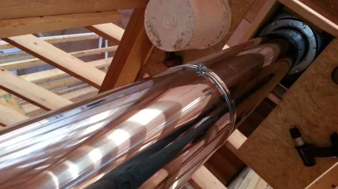

cant you set one section of pipe in place(supported and lined up well of course), then let the roofers & drywallers do their thing? Then you can slide the temp pc out and do the full stack install when the time comes?
Not sure of that brand, but most brands sell a "through wall kit" or "through ceiling kit" That has everything you need less the piping itself.

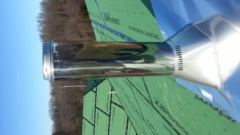

I installed that Supervent Ceiling Support kit in the bottom of pic. It had everything (except stove pipe, Class A chimney and silicone caulk) for an asphalt shingle roof. Your metal roof probably needs a different flashing boot. Your roofer should know.
