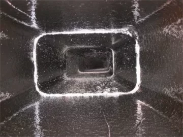

My chimney is glazed . I had it cleaned but they did not remove the glazed part. Is ok to reline with stainless or should it be removed before relining.
gerry100 said:Not to contradict the experts but-
When I brushed my flue for 28 years before the liner was installed ( with the new stove), there was always a hard shiny glaze left.
Never had a hint of a chimney fire.
gerry100 said:My confusion is , why shouldn't the hard glaze inside a chimney not be a hazard but when it's separated from the exhaust by a liner it is?
