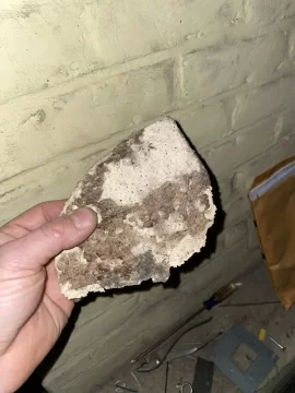

Edit: found this chunk in the clean out in the basement. There appears to be 2 holes. One has brick chunks showing and the other just with this piece missing out of it..

The pictures don’t do it justice but there is at least a 4-6” hole in one spot and then a big chunk missing with broken bricks coming through the broken terracotta in another spot. And then gaps between the tiles toward the top. I’m surprised it has been said continued use is suitable in this condition? Wouldn’t these large voids allow carbon monoxide into the air space between the chimney and flue and possibly get into the house ?
