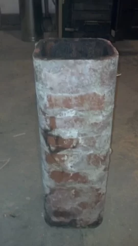

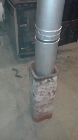

Hoping to finish it tomorrow, I've gotten it down below the roof line using a 3lb shop hammer and cold chisel. Its really not as bad as I expected, the rain and ice over the years have done a lot of the dirty work for me by making lots of hairline cracks, the liner being mortared to the brick is actually to my advantage. Every couple layers of brick I take down I'm able to break the liner into manageable pieces which prevents me from having to worry about huge chunks falling down into the smoke box.
Reactions: pen
I'm also finding about 1/2" of creosote between the liner sections at every joint, the mortar in the attic section is soaked with water and creosote. The previous owner almost had me convinced it would be fine to just reattach the wood stove and fire it up this winter _g ... I'm sure glad I spent hours on end reading post after post about relining masonry chimneys. Hopefully by this coming winter that new Woodstock Keystone will have a brand new exaust system and a new hearth to rest its feet on!! :cool::cool::cool::cool:
Sounds like it is going better than this.

If it is that bad I strongly recommend having a sweep look at it. If creosote was seeped in that badly it might need the liners removed in order to safely line it. I don't know without seeing it but your description is a little concerning.

Wow that did one hell of a job on that roof

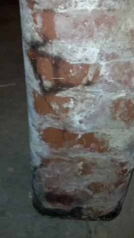

I'll do my best to post some pictures of it tomorrow afternoon, it looks to me like the double brick portion I'm going down to is very clean. I'm going with Bholler on this one, had there been an airspace between liner and brick the liner would possibly be in better condition.
Ok I would just check it out closely you really need to be able to get it really clean before you line it and if creosote has soaked in there is no way to do that.

that doesn't look that bad really not much dirt outside the liner but still inspect the rest very carefully the best thing would to have it scanned with a camera.
