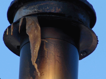

The past 24 hours, a near historic snow storm moved through. It blew all kinds of snow through the roof vents in my pole barn for the first time in 15 years. No big deal out there though. But at the house, I now have the weirdest chimney cap dribble icicle. I check the cap several times daily and have not seen this before, hoping the driven snow is the cause. (attempting to figure out how to attach picture)
