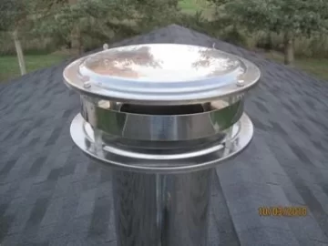

I had another thread going on smoke coming out of my stove door when I open it. I am pretty sure the mesh on the cap is getting clogged, although the rest of the pipe is good. I am hearing alot of people have trouble with the mesh clogging and I would like some input.
How many people got rid of the mesh? How do you clean it? Did you ever have any problems with it? Is it a bad idea to get rid of the mesh?
I tried my bottom up Soot Eater and it could be I am not making it all the way to the top, even though I hear loud banging. I may need another section on my Soot Eater. I tried to climb my 30 foot ladder, but not long enough. Now trying to borrow a 40 footer.
