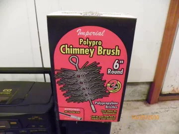

My professional opinion is to use poly brushes. I am not gonna risk getting a wire brush stuck or ripping a customers liner with it. Go poly and have no worries.
kwikrp said:
I have a 8 inch flexi stainless steel linear and was wondering weather I should use a metal bristle brush or the nylon bristle brush ?? or anything else?
Thank You

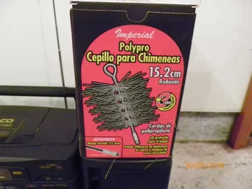

This is the brush we use except ours is a six inch, works great for us.
