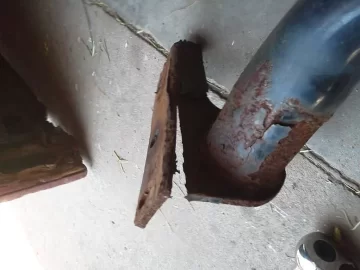

I bought a class 3 hitch about 7 yrs ago for my xterra to pull my flatbed trailer and my enclosed 6x10.
I noticed a new squeek and a different angle to my hitch last time I pulled into my driveway.
It is pulling a part.
I am quite surprised. I think I am pretty conservative with my loads. Could have been a disaster.
Don't assume its ok. Check them occasionally.

Lucky you found that :eek:

My class 3+ receiver bolts to my rear frame along beams, so that kind of break cannot happen.
But geez Louise. Not good.
This one bolts to the frame also along the beams.

No, what I mean is that my receiver has beams on either side that are bolted to the frame in 3 places (along 3 feet of frame). The hitch is larger/stronger than the frame.
Reactions: ScotO
I don't like those tube-type receivers......because of that very reason. The mounting tabs, IMO, are way insufficient to be pulling any kind of big load......
My receiver is like Stihlheads.....two brackets with three 1/2" bolts each, the cross tube (heavy rectangular tubing) slides into each one of the brackets and is bolted in place with (4) 3/8" bolts. One of my bigger fears when hauling a big load of logs to my buddy's mill is that hitch failing. I don't EVER want that to happen, so I made certain I had a good receiver.....
Thank God you caught that failure....that could have been catastrophic.

I chucked the factory ford hitch and bought a new curt super heavy duty hitch with none of those WDH requirements. I was very impressed with the curt quality.
Do you have a corrosion problem in your location? With so much salt and metal disintergration you folks always have to be ready for the dang things to fall apart on you. If not the hitch then perhaps your main frame would fold up.

Mine is a class 3 hitch, and fits the Sequoia SUV as well as the Tundra PU, though it is designed like a bigger badder class IV & V, and is built like Scotty's description.
I looked at a lot of receivers out there, and got a Surepull. The frame is likely to come apart on my truck before my hitch system does. Actually Tundra has a recall for frame rust, but that is only a problem where they salt the roads and the frames are rotting out. No salt on the roads in Oregon, except a small section southeast of K-Falls. Last time I was in Boston I was amazed at how many newer cars were completely rusted out.
