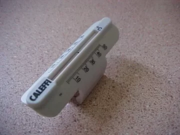

Here is one I like a little better. It will fit 3/8- 5/8 pex and 3/4 copper. Easier to move around and not much more $$. The sample is in C I believe the new version reads C & F.

Hot Rod- what's the description or part number for that nifty unit you show above?
