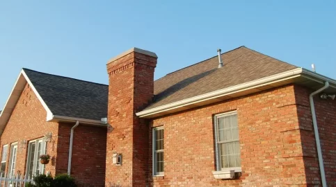

This is a Quadrafire 7100 ZC fireplace that I'm putting in. I have an existing exterior chase that is framed with 2x4's sheathed with OSB and then covered with bricks all the way up. It originally had a direct vent NG fireplace installed in it. So far I have insulated it up to the ceilings at 9ft and sheetrocked it with 5/8" Type X.

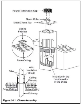

GB, I think you are fine stopping the insulation at the firestop 9' level. Follow the stove mfg. recommendations.
  • [Hearth.com] Chase Ventilation - Defeats Purpose of Insulation?
