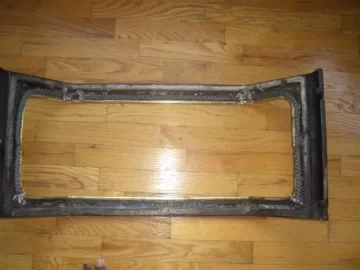

Hello to all the experts! I have a Breckwell PF2000FS Pellet stove. My pellet stove is 3 years old. The glass always soots up quickly. So we decided to take the glass off...clean it and change the glass gasket. After this was done we fired her up...and the side glass cracked. We ordered new glass from Breckwell. Changed the glass gasket...but the glass wont fit. It's the correct size...but the alignment is'nt right. How bout you Mr. Pyro...can you help??? :)

I'm a little confused can you post a picture? The "alignment" should be there if it's the correct size, unless the glass isn't square or something.

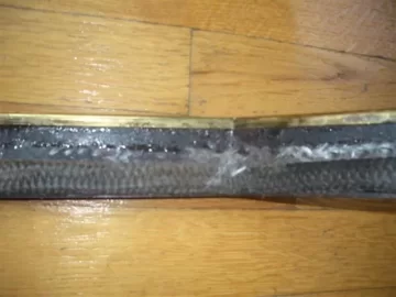

The problem is this. There are 3 pieces of glass that form together by two metel corners inbetween each glass. The glass presses against the glass gasket to create a seal. I replaced the gasket with one of the correct size and width from Lowes .When I tried to reinstall the glasses they would not align with the screw/bolts that are on the door. Ive already broken 2 pieces of glass trying to reinstall them. What am i doing wrong!?!

The new gasket you used could be a little thick
Or
The Brackets for the corners or the hold down bracket could be backwards

OK guys here are the pic's.

Cant see where you say it will not fit
In the corner?
did you remove the old gasket and cement before you but new gasket in?
Best to call Breckwell.

Hard to tell without having the door in front of me.
