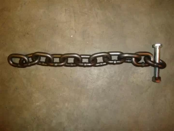

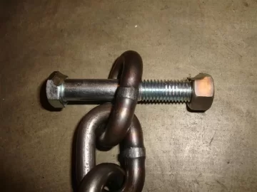

If there is interest, I will provide, first come first served, with barn cleaner chain cut to length for turbulators for the Tarm. This is what I have been using since Jan 2008. These are over-sized links which fit the 3" Tarm firetubes with good clearance all the way round. I'm not looking to make money on these, but I do need to charge a small amount for my time in cutting the chain and packaging for shipment. Shipping would be at cost, hopefully PO flat rate box. I will provide more info, if there is sufficient interest.
I apologize if this is regarded as a "sale" plug; it's not intended to be. I have quite a length of chain which is of no other use to me, and these do work very well.
Chain Turbulator
Chain Turbulator 2

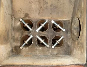

Jim,
Thanks to you, my turbulators are now in place. Thank you for the tip & photos!
I used 18" lengths of 1/2" chain from a local industrial supply surplus store and have them suspended from 5/8" bolts. They've only been in place for a few hours, so I'll have to give it some time before I can tell how much they help.
